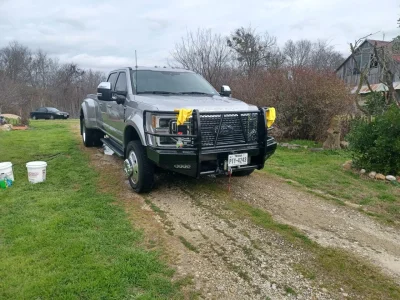

One of my tow rigs. I use my Tacoma for 5x8 uhaul trailers. I have a F350 dually as well as a 379 Pete.
