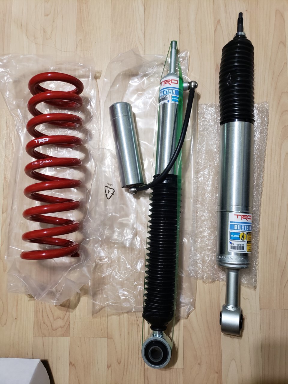

I keep looking up 5140 every time you mention it. Is that just the TRD version tuned by Toyota?
Haven't seen a Bilstein 5140 offered. Can only find 5140 within the TRD Suspension part number: PTR13-35140
Is it like a 5160 without the reservoir?
Is it this?
