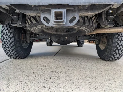

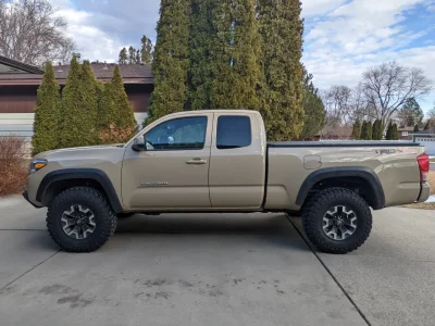

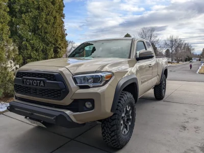

Results of the Pizza Cutter Shootout...
I went with the Toyo Open Country MT's. I think it is a great looking tire. As an MT it is a little louder on the highway (low hum), but not too bad. It didn't increase the decibel reading at all.
I expect significantly better off-road performance, which is 80% of what I do.
Discount Tire guys struggled to get the spare to fit, but finally were able to squeeze it in there.
Got an alignment this morning and it drives great. Really makes the truck look like a truck.
I wish I had pulled the trigger sooner.
Looking forward to Moab.
