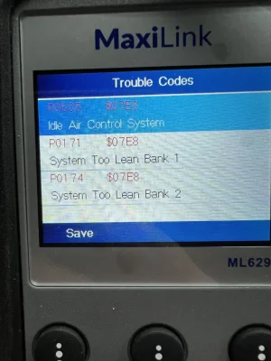

I have a 2017 Tacoma trd sport and it just now started to have an issue that when the engine is hot it won’t fire back up if turned off it’ll crank fine as if nothing is truly wrong with battery and spark plugs I have to jump it to get it going again it is throwing 3-4 codes; being idle air control sensor and boot 1,2 are lean. Can’t think of anything wrong cleaned throttle bottle and air intake dumped a bottle of fuel injector cleaner in no luck im new to this forum but any help is greatly appreciated

So if it jumps off, I think you're looking at either an electrical connection issue somewhere between the starter to the battery that may be corroded, and when heated (and therefore expanding) is having problems connecting, creating more resistance and making your truck think there are sensor issues.
Or it's a bad battery. Hope that's it. I'd check the battery first.
Upvote 0
Yah I checked the battery thank you I’ll look into sensors battery is good at 13.8
