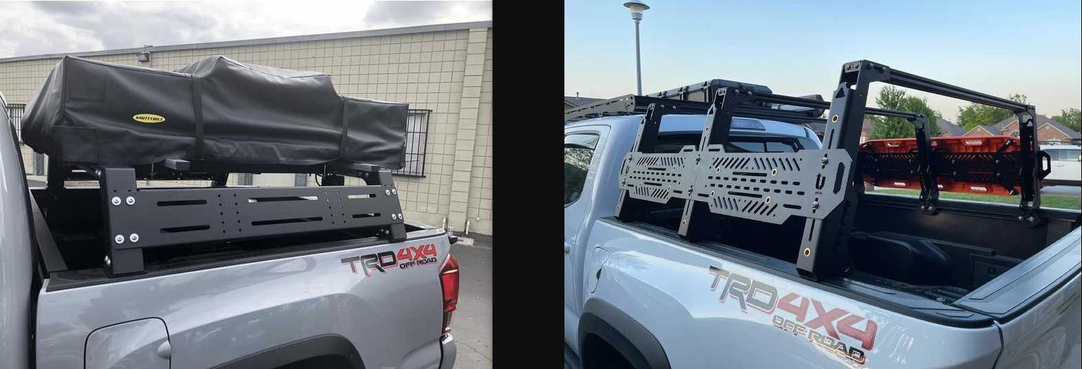

If you are open to suggestions, I wouldn't purchase CaliRaised or RC. There are many better quality options in the same price point.
CaliRaised is known for their crappy service. Just some kid's son going into flipping Chinese LED's. Then branched into hard goods. Most of their stuff is bulky. Rougher end product. You can even search Facebook Groups and Forums for people's experience with CaliRaised.
UpTop has a much nicer finished product. Customer Service is great. Wait for a sale and it'll be the same price wise. Black Friday is coming up. Wait times just suck all around no matter who you go with. Buy CaliRaised and you'll regret it later.
I doubt you'll find anything negative on these guys. The only bad thing is they discontinued the UHL and I needed yesterday.
You can see the difference.

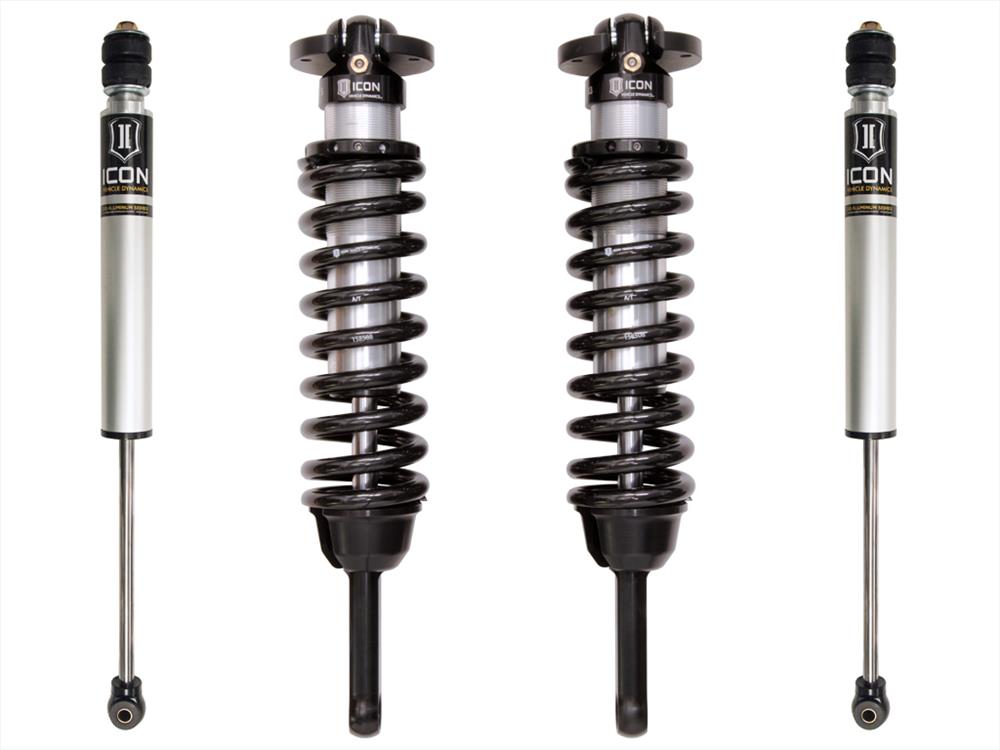

As someone with 5 truck/jeep builds of experience, I would save a bit and invest in a solid lift. Doesn't have to be Icon's stage 23 for $6000 or Accutune's rolls Royce, but you want to get a reputable company's lift and don't go cheap. I've done my share of spacer lifts only to re-spend the money in installation a year or two later for the actual lift I should have just saved a bit more for and gone with one time. "Buy once, cry once" is a very true proverb when lifting your vehicle.
I'd suggest the bilsteins, icon early stage, or OME if you don't mind squeaky rear springs :). Think carefully and calculate your loads (winch/bumper? rear bed rack/roof top tent? rear bumper?) before you buy, then budget, save, and buy the kit that fits your needs.

$1800: Icon's stage 1 leveling kit. Does nothing to the rear except exchange shocks, lifts the front just a bit.
$1700: OME's full kit, addresses the rear springs also. More comprehensive, shock quality not as good as Icon, but quite adequate. (btw, Icon, Fox, and King's are top of the line shocks)
$700: Westcott design's front preload spacer lift kit
I'm currently running Wescott's budget preload spacer lift in the front on my TRD Pro 2020, which includes a one inch block in the back. Costs $700, no need to change shocks. Had a guy install it for me for $250. A little stiffer in the front for a few weeks, but has since settled out and I'm quite happy...with TRD Pro Fox shocks, mind you, which are quite nice from the factory.
Most guys mix and match, or just drop $5-6000 on a full kit from Accutune or Icon and move on with life :)

I like Icon stuff but just have seen a lot of reports of them leaking and stuff.
I felt Bilstein would have better reliability.
