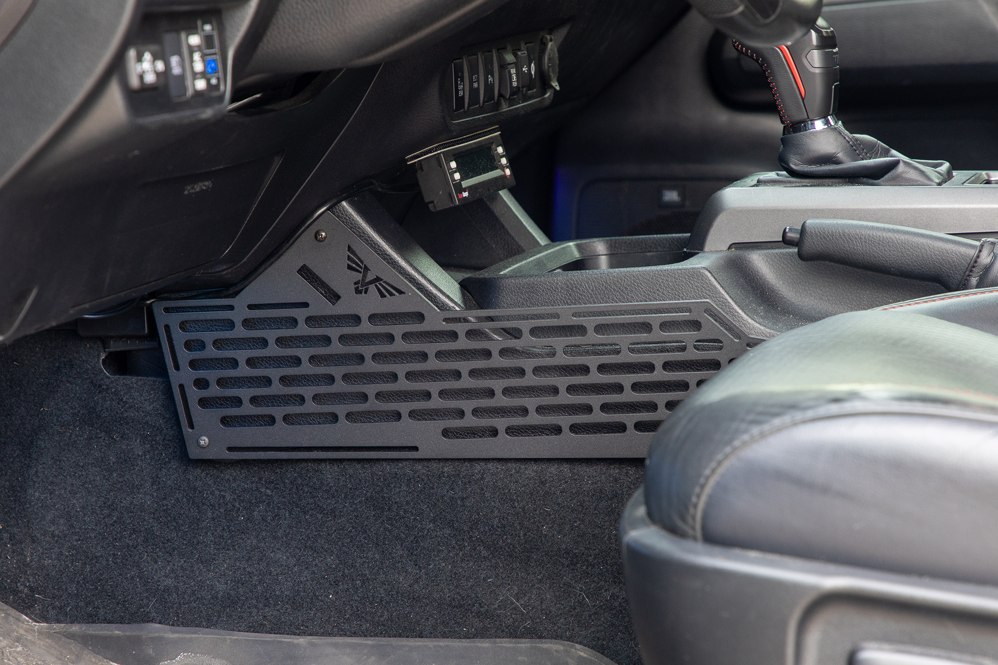

I use my laptop in my truck a lot but it isn’t very comfortable. I was thinking about however police cars mount their computers, or even if there’s something that could mount to my @ExpeditionEssentials rail. Or maybe this thing on Amazon. Any suggestions?

To add it to it would be easy. Just get a RAM ball-mount to the laptop base. Then T-nut to the extrusion with the RAM arm.
RAM makes a no-drill mount:

I have a front multi panel mount from Desert Does It that does unused. But it is a solid mounting point.
Their seat jackers are threaded in the front. So that gives a solid mounting point to bolt something down.
Then buy a simple laptop desk mount from Amazon. Looks like the base is 2 pieces. I would remove the button, drill holes to bolt it directly to the seat jackers or could probably bend the plate to fit under the seat mount. Maybe even make a long plate to go under both seat mounts. If you do single, just find a spacer or something the same thickness for the other side.
