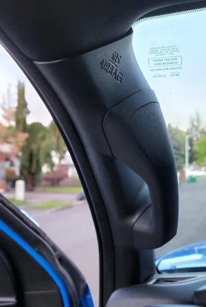

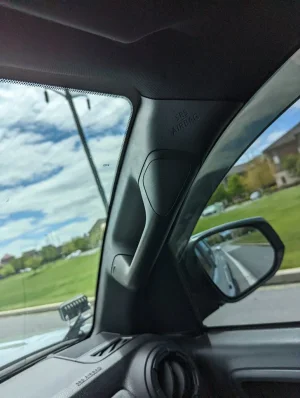

So... I think I got it on there correctly...? Could I compare with the ones you guys did?:

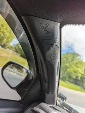

Kind of have to adjust it. Set it before tightening the bolts. Like push it in position against the bolt. Even the factory passenger side is off a little.

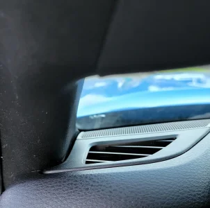

Yeah, it is definitely more flush than mine, when I was doing it yesterday it seemed like when I was trying to place it it there was a blockage getting it flush with thevA pillar, did you have the same issue?
Upvote 0
Might be little locking/hook tabs that need lined up. If you smashed it in they could be bent and stopping it from seating completely. Remove and check. Won't be perfect.
