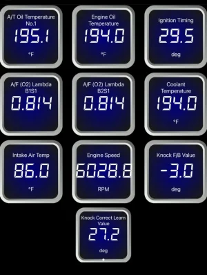

Oh, and if anyone is interested. On the Tacoma 3.5, 30 degrees of advance under WOT is about as good as it gets. I would not be doing this if I did not log and actually see what the ecu is doing.
Upvote 0

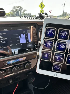

I’m OTT tuned, but I was logging before and after the tune to see what’s up. Injen intake is great too.
Upvote 0

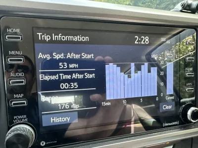

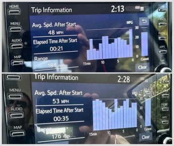

Surprisingly still getting 25+ on the highway at 65. The mix is not that high. Drops down to around 19 at 75 and up.
Upvote 0
Just to confirm, that's kilometers right?
No, miles. 75 - 85 mph vs 55 - 65, back to back. I generally tank average 18 - 19 mpg.
