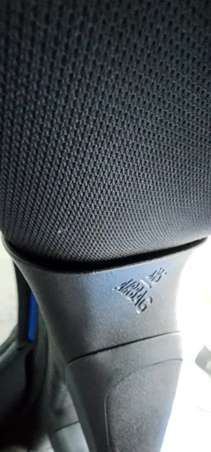

Also one other sort-of issue it the grab handle on the driver sidenot lining up with the post any of you have a better solution to put that dang piece in the flush up with the post? Lol

Post a picture of the grab bar. If it's the one above your head, I think it's held in by a clip. You have to seat it correctly then press in to keep it in place.
But when you say post, is it the one on the A-Pillar? If it's the A-Pillar one, then it's aftermarket. To get that to seat better, you'll have to pop the caps off. Unscrew the bolts, but don't remove them all the way. Get enough room to pull out the handle. Try to fit it by tightening both bolts evenly.
Here's a pic of the grab handle & vid of what the moon roof is doing. Yeah it's the one on the A-Pillar & it's the aftermarket Kyro grab handle that I bought off-line. I'll take it off this weekend & send a pic of inside the pillar. Thanks for your help

I have the same one and mines the same way. Just one of those things I've learned to ignore. Since it's not OEM, it's not OEM quality. Only thing I can think of is to heat it up enough to reshape it a little. You could also remove it, then file off some material at the base where it seats top to make it mount closer to the mounting point. That would draw it in closer. Your post actually just made me think of that. I might give that a shot if I ever break my laziness.
Heat gun and something soft ish and smooth to hold against it to not leave marks. Too hard/hot and flat will flatten out texture. Could try taking off the weather seal and placing some type of spacer between the ceiling and roof to push that part of the ceiling panel down into the grab handle. Something like polyurethane foam.
