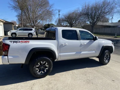

Can anyone tell me what the stock suspension height is

Not exactly sure what you're asking. The ground clearance for a trd off road is 9.4 inches, measure from the lowest point of the underside to the ground (roughly lower frame to ground, though there are a few bolts, bars, and exhaust pieces that squeeze a hair lower).
trd pro's add an inch to that, but that's all dependent on load (full tank of gas will change it, much less stuff like gear or a truck bed full of stuff, or a cab full of people).

Thank you just want to know what suspension to go with to get a 2” lift Above stock height
Any suspension advertised as 2" will work. Is it a bigger tire you desire or plans to do something more.
If you wish only to remove the rake, the difference between front and back a leveling kit will work. In this choose one in aluminum with thread in studs. Welded metal uses threaded inserts prone to spin out when strut maintenance is required.
Next level, there are front strut replacement lifts with a small rear lift block in the 2.5-3" range that work well and won't set you back to bad. They will use the upper spring and component from your OE strut. Choose a kit with upper A-Arm replacement to help with alignment and correct ball joint angle.
If you are going be adding a lot of weight i.e. bumpers, winch, extras batteries, rack, and gear, look into an option that provides heavier springs front and back.
Be sure to search wheel and tire fitment for proper wheel offset and tire sizes to avoid tires rubbing.

Grab a tape measure. Take a look. Measure a bit. Will do you good to learn your truck.
If my memory serves me right the (RAKE) I believe its called is 1"
I definitley could be wrong if someone knows for sure.
I measured it from level concrete and it was spot on when factory.
Measured to middle of fender flare.
Front was 1" Lower than rear.
