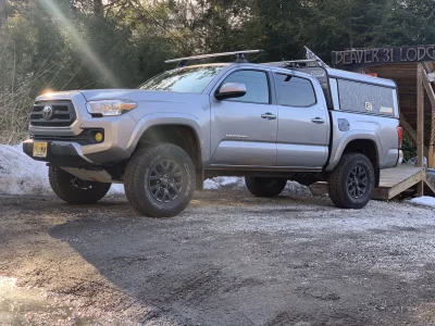

Hi. Im noah. I live in NJ. Ive had a Tacoma about 9 months. This truck is my daily. I have a 27 mile 5day/week commute in classic Jersey traffic. I drive like grandma. Im the guy going the speed limit on 80 at 5:30am. My intentions for this truck are for it to be as capable as I can get it while still getting decent mileage. I won't be chopping into the frame. I won't be lifting higher. So it'll likely be a humdrum boring addition to the trucks here. But I find it to be a much more interesting endeavor to balance seemingly opposed goals (road manners/off-road capability) than to just throw as much money at off-road gear as I can and suffer driving it 90% of the time. So the modifications I make in the future will always have that balance in mind.
2020 SR5 DCLB 3.5 4x4
I lifted it:
B-stein 6112 4/5th clip
B-stein 5160/Icon aal/overload left in (wish id just gotten a damned full pack)Added an ATS Spring pack, HD w/overload
JBA uca's
Tom Woods Drive Shaft
Hammer Hangers/crossmember
U-bolt flip+superbumps
ECGS clamshell/needle bearing swap
Tires:
Cooper at3 LT 265/75/16
Shell:
ARE DCU
Front skid:
J-Dub Fab (local metal guru)
Sliders from Explore Overland

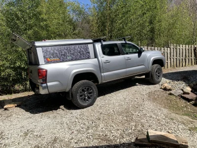

Added a little of what was left over from last weeks vinyl debacle. I like that it breaks up the massive wall of silver, but am undecided on the color/pattern. May do something different another day. I don’t hate it. Good learning experience though. The second one took 1/4 of the time to apply and looks a lot better. Less bubbles and wrinkles. Anyway. I’m trying to keep up with this thread best I can. More to come.

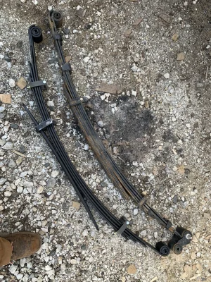

Finally got a real spring pack. Ride is night and day better. The new ones are from ATS Springs in Souderton, PA. Super helpful. These are their 4x1 pack. I believe Bob Jr said they are a HD version of the 4x1 pack on their website. If you’re in the area, it’s well worth the drive for the savings you get at $450 for both sides. HHers next. Should be here by the end of the month.

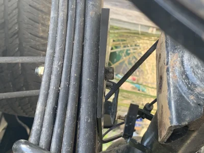

Swapped out the Aluminum shims that "floated" between the axle and leaf pack for steel ones that bolt to the pack. I wish I understood why anyone would even make such a thing...
Anyway, Ive been driving like a little old lady since I found out they were the wrong thing and I will commence smashing my rear wheels into everything I see without fear of spring/axle separation...
