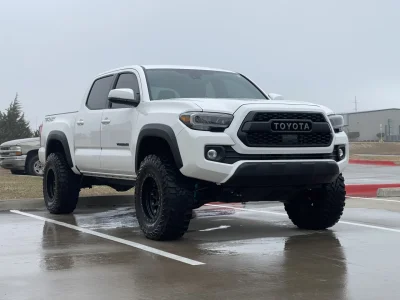

Hello all, recently found a 2021 Tacoma TRD 4x4 Off Road for what I thought was a decent price considering only 15K miles.
Tacoma came with what I think is a 3 inch King lift with reservoir's with OME add a leaf in the back (Medium weight I think).
Also came with Stealth Custom Series 17" wheels wrapped in Yokohama Geolandar G003's (285/70/17)
It does have a skid plate added around the transmission area (No brand I can see), Could be a cat shield but a buddy said it was definitely a transfer case skid plate.
This thing is soooo solid and ready to rock nd roll.
I LOVE IT, although I definitely see a tune in my near future because the transmission hunting is driving me crazy!!!!!
Please take a look at it and let me know your thoughts.

Welcome! Truck looks good dude but I'm a little bias towards white 21 offroads. 😁
Welcome! I LOVE your wheels you got! Nice rig! Don't go too far into debt building this thing lol
Thank you!
I honestly would prefer bronze, but these are growing on me 😄
I could die tomorrow, who cares about debt 😅😅😅
Valid lmao! I was going back and forth between bronze or black, I think Ima go with bronze tbh
