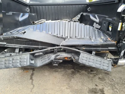

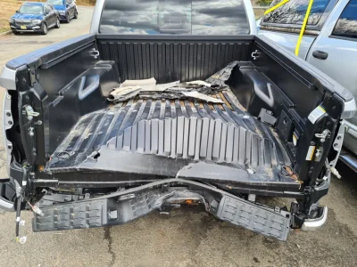

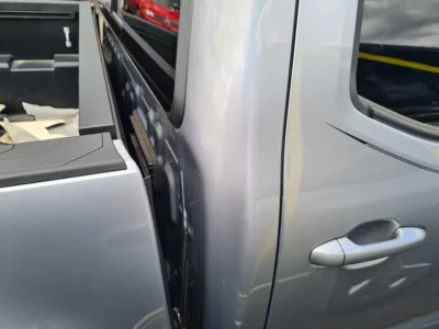

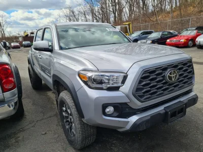

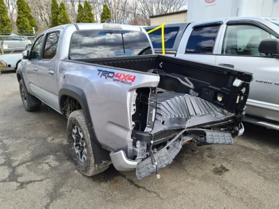

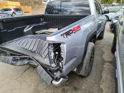

Hi guys, sorry if this post has a lot of grammar mistakes but english is not my 1st language :) Im Nick and i just bought a 2020 Double Cab TRD OFF Road Tacoma with a salvage title. Im going to import it to Poland so i wont have acces to any parts here, and i thought the best thing to do will be to make it a flatbed. I wanted to ask you a couple of questions first.
1. Should i buy a lift kit first or will the stock ride hight be enough to install a custom made flatbed?
2. Is the rear bumper reinforcement needed or should i make one custom?
3. I am a pretty good welder and have my own shop but i think i will have a lot of problems designing a flatbed my self, could you please recommend some design with a lot of photos that i could base my design on?
4. Any tips on what should i buy before my broker ships my car to Poland?
Im very enthusiastic about doing it by my self :)
Thank you in advance for any help you could provide. Below i will post some photos of the car taken by my broker, that will ship me my car.

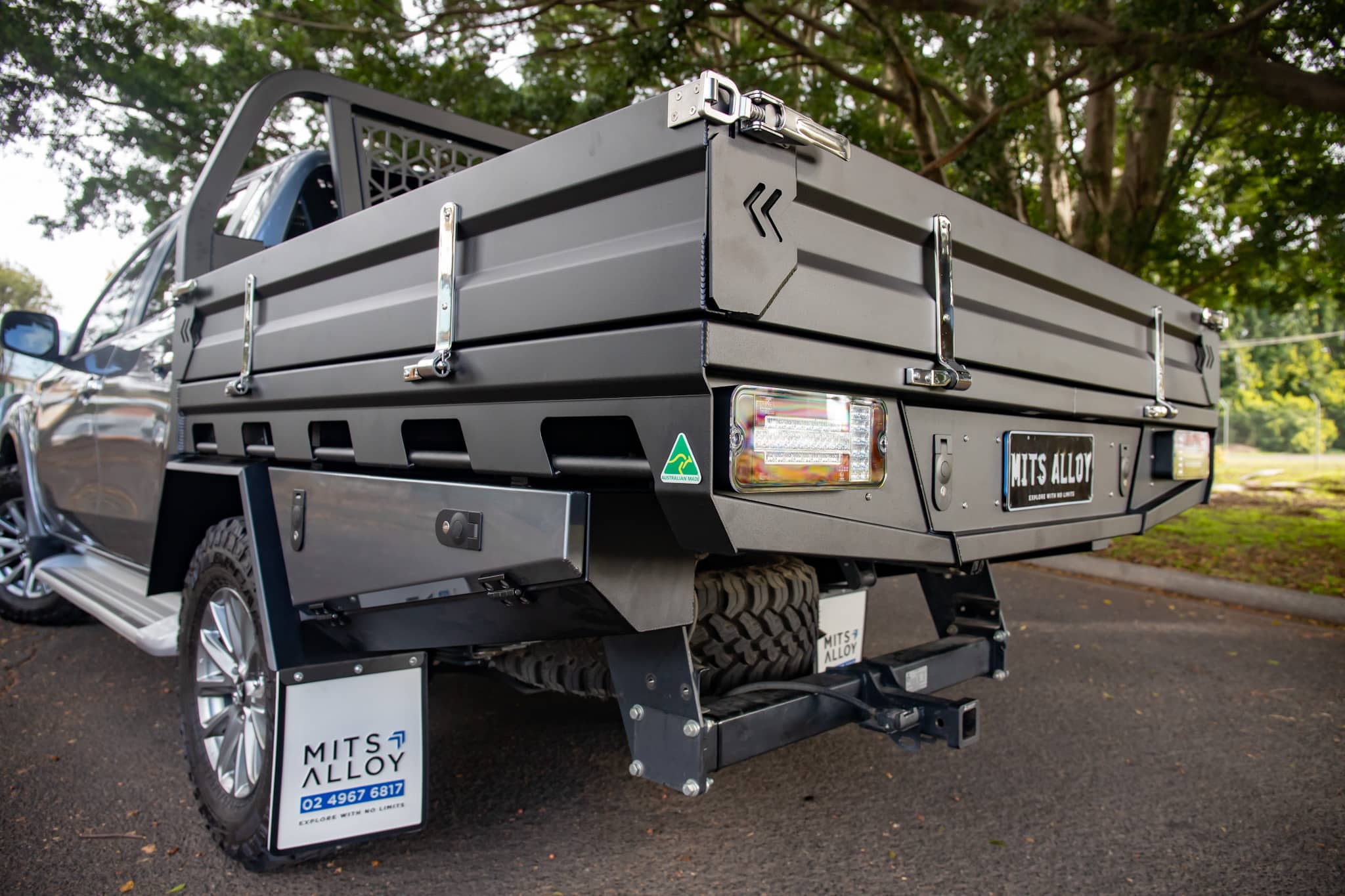

The Mits Alloy flatbeds are an amazing product in my opinion, however extremally expensive, the reason I mention them is if you can see one in person they are a great design that may give you some ideas, I also agree Tacomadad is a great source!
