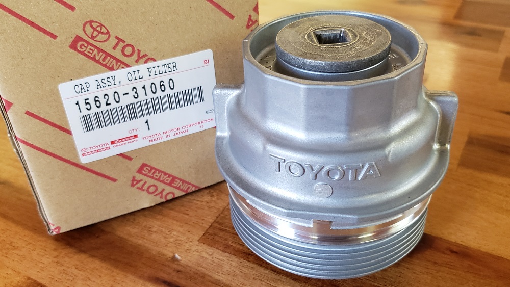

This is real Toyota genuine? Is it meant for the Tundra but fits on the Taco?
Yes, a genuine OEM Toyota part. Maybe a universal part? I grabbed mine on Amazon. I'll double check the part number.
Then had the dealership throw it on during those free oil changes.
Yeah, it's
15620-31060.​
If you look at compatibility...
But when you look at it for 15620-31060, it doesn't list Tacoma for some reason. But that's how it always it with these parts listings. But it fits @Tyler, I swur.
Yeah, it's
15620-31060.​
Right on. Gonna order one of these bad boys in that case.

Would it be this one? Just checking because it’s plastic in the photo but based on the reviews, you do get the aluminum one.
Genuine Toyota 15620-31060 Oil Filter Cap Assembly https://www.amazon.com/dp/B008BHP68A/?tag=tacoma3g-20
Amazon is blocked where I'm at. Just order the one with the metal one in the photo? I'd assume the part number should all be metal. Since a different material would be a different part number.
