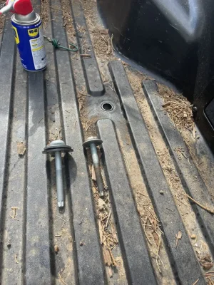

Quick question. The squeaking sound coming from the rear is driving me nuts. I have a leitner designs rack with bed stiffeners and just added some Bilstein 5160s. I saw a video of a guy replacing the six bed bolts and adding a rubber washer top and bottom to alleviate the issue. I have done so but still hear the squeaking sound, have you guys done anything to solve this? thanks a lot.

Are you sure its the bed bolts and not your leaf springs? It’s pretty common for the springs to squeak. If it really is the bed bolts, make sure you’re tightening to spec

Yeah, I vote leaf springs if you've already done the bed bolts.

It's more than likely your springs and/or shackles. My OME Dakar packs were absolutely embarassing. The spring squeak stopped when I put the Deavers on but the shackle itself will still squeak at times. Check your springs and shakles
