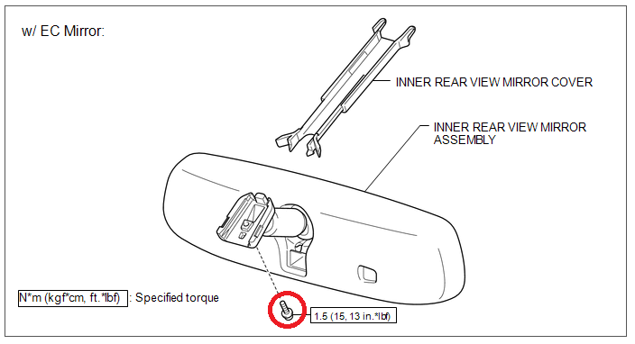

I'm gonna make something really neat. I'm sure people with dash cams would be interested. Could mount anything really as long as it can support it. Not meant for much weight.

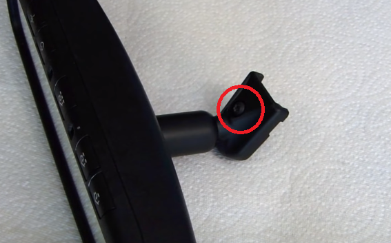

I need measurements of this screw and the opening it sits in. You just have to remove the screw, measure it and put it back. Hoping someone with calipers can do it.
I'm pretty sure it's a T15 Torx and proper torque spec for installation is 13inch/lbs.

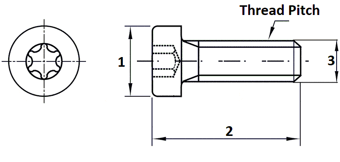

The important measure measurements are:
Even better if you could identify thread pitch.
Also the size and depth to the shoulder of the hole it sits in.

I don't know how to check the thread pitch, but I can get the other info!
And, yes, it's a T15
Shoulder:
