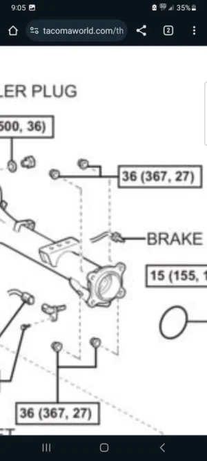

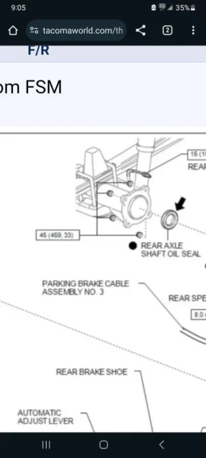

Axle nut recall torque for my 2023. What is that value, NM or Ft/lbs? Is it 27 or 33? I see both. Dealers say bring it in..nope. I'll lose 200k off my clutch.

Are you asking about SAFETY RECALL - 24TA05? Do you have the complete repair document? I am seeing Torque: 55 N·m {41 ft·lbf} in the repair document.
