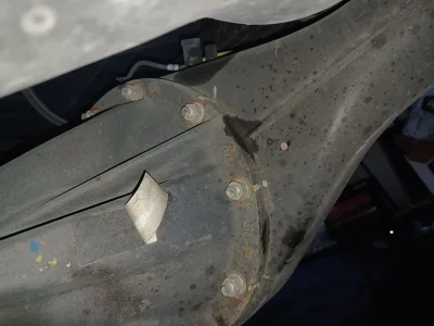

Is this the dreaded axle leak?

Noticed this on my 2023 Sport. I washed it off, I'll see if it comes back. I thought that it was just roadkill spit because it looked clear and didn't have a smell on my fingers.

Looks like some lube escaped the vent. There's another spot above the one you are considering to be a leak. Remove the vent and listen for pressure to escape.
As mentioned, check the vent. Also, throughly clean the axel and see if it comes back. It could have come off the road or something you hit.

I got exactly 4 qts out. I put 4 back in. It didn't dribble out of the filler hole, but I checked it with the stinky pinky and the level was just a few millimeter s below the hole. I called that good. I washed the whole axle. I was Definitely coming from the vent.
When I pulled the fill plug, it made a long sucking noises...I have a vent ordered
