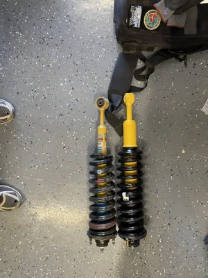

The OME lift (update)

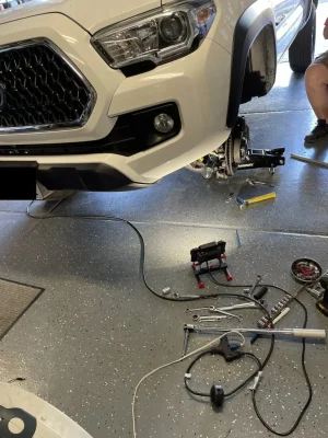

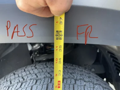

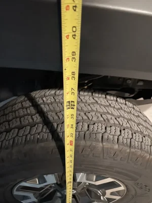

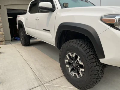

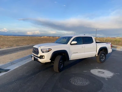

Lift and tires are in. The medium OME 2” lift settled out close to 3”. Bumper and winch up next, will see how she sags. Ride is not too stiff but I’m also not too picky about those things. Definitely have the 25mph vibe, so I will be looking into a straight driveshaft swap. Still waiting on the matching OME UCAs… so at full lock the BFGs just kiss the front of the stock UCAs. Checking the ‘ol parking lot flex, there seems to be good clearance otherwise.

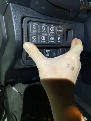

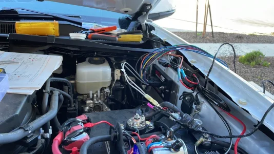

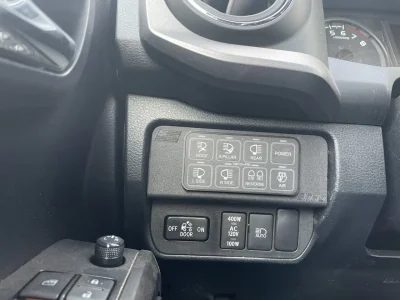

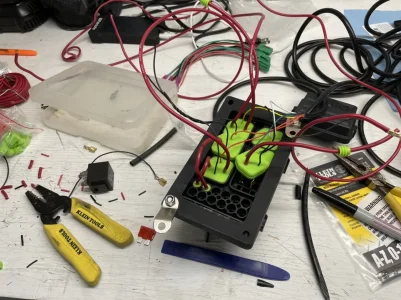

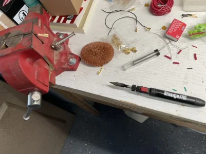

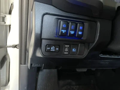

Spent some time wiring up the new switches and power boxes. Pulled control power from the USB power supply in the cab, so lights won’t be on without it being in accessory. The dust/water resistant bus bar and fuse/relay boxes were a pain to assemble, and didn’t have a provision for smaller control wires… so I crimped and soldered a lot of the connections. Waiting in a few parts to come in, so for now the only thing that lights up are those bright Cali LED switches.

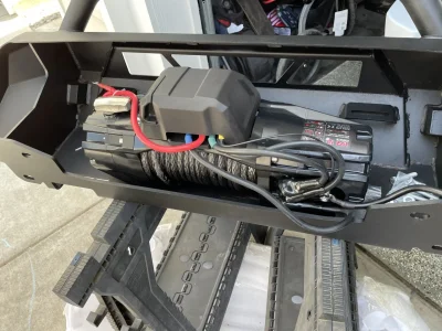

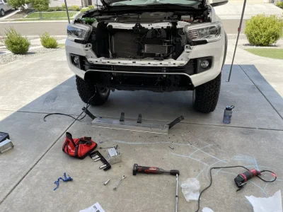

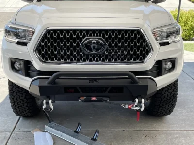

Bumper install over last weekend. Took about 2 hours, hardest part was taking apart all the plastic body clips.

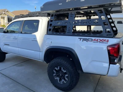

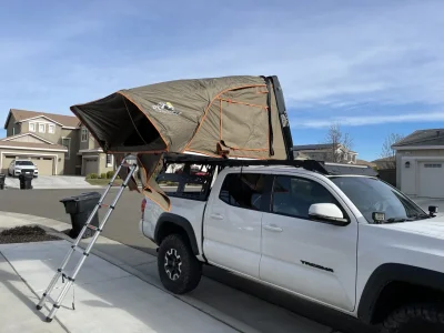

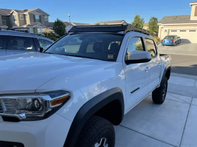

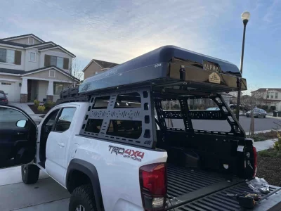

Bedrack and RTT. Have a trip planned this month, should get some nicer pics!
The weight bringing down the OME rear leaf springs to design ride height resolved the 25mph vibe, which is nice because the drive shaft monies will be spent on air bags for when she’s loaded up all the way.

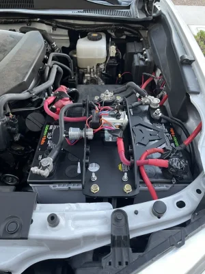

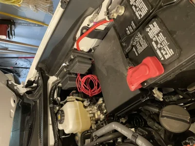

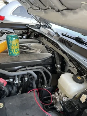

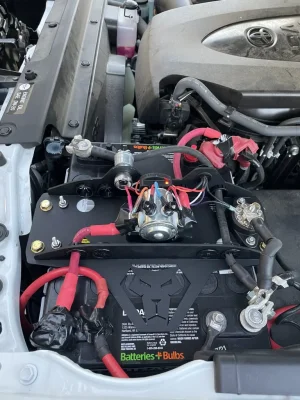

Little behind… and missing some progress pics, but here is the dual battery setup. People go fancy on the batteries, just rocking a couple of AGM Marine/RV deep cycle. They are half the cost, and still have a 4 year warranty so I wasn’t too worried. FYI you CANNOT change the charging voltage of the alternator without OV tune, the old resister trick doesn’t work since gen 3 is controlled by the ECU (lessons learned, research first). In the interim, a 5amp Amazon special will be conditioning the batteries every quarter or so until I work up the courage (and pay down the credit card…) to pop for the OV tune.
If anyone wants some tips hit me up. I’d recommend checking figment no less than 3 times, get an Amazon special rivet tool, and the fancy drill bits with the 13/32 drill bit for the 1/4-20 hardware.

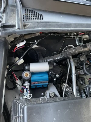

And I finally wired up the air compressor that has been bolted to the CBI mount for two months. I used the supplied wiring harness for the pressure control end, but with the E locker I omitted the wiring loom for the master, forward, aft switch setup (kept it if I ever want a front air locker…). The control power for the switches are powered by an aux 12V supply that only on with ignition, so the start button does this job just fine.

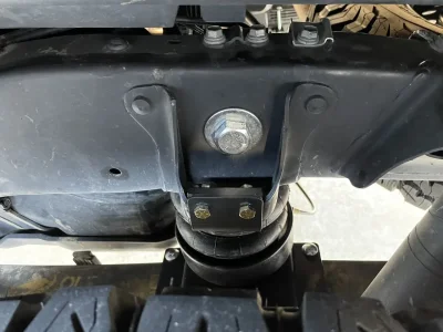

Air bags!

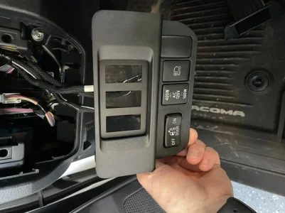

I finally pulled the trigger on a switch pro. I can say it is freaking awesome to turn on the 12VDC to the truck bed and light off my electric blanket, from the comfort of my sleeping bag using blue tooth.
I had a custom fuse/relay setup that I spent a few weekend wiring and it worked great, just didn’t like the 4 switch limit I had going.
FYI - don’t buy stuff from CaliRaised Off-road, part didn’t fit and the support team argued with me about the return. I even sent pics comparing OEM to aftermarket measurements with a caliper. I don’t mind when there are manufacturing issues, stuff happens… just own it and send me another part!
So now I have the SDQH panel. A little trimming required on the back, but nothing major.
