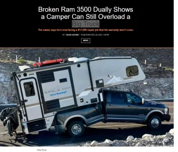

My 2022 Dbl Cab Sr5 has a 990 pound cargo capacity, based upon the plate in the driver's door jamb. If the dry weight of the camper is 935 pounds, by the time you add stabilizer jacks, passengers, water, food, pots & pans, propane, clothing, gear, and any options that are not part of the dry weight, you will be well over the max cargo capacity of the truck. You can add all the suspension goodies that you want, but those will not beef up the frame, the drivetrain, the cooling system, or the brakes. See attached

According to Toyotas website, a 2023 v6 4x4 5 foot bed has a payload capacity of 1155. Not saying you’re wrong for what your truck says lol. Just thought I’d add what Toyotas website says

Well, they say that you should always believe what you read on the internet, especially when it comes from somebody who is trying to sell you something. Even if they upgraded from 2022 to 2023, that extra 165 lbs is still likely not enough to keep you from overloading

Oh I don’t disagree. It’s a lot of weight for these trucks
