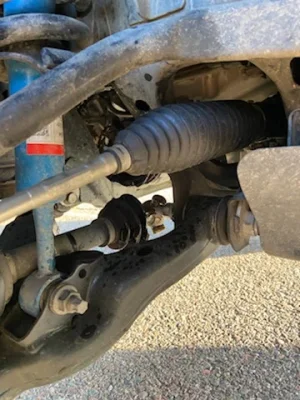

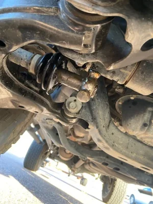

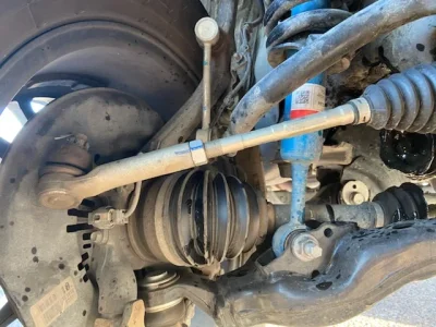

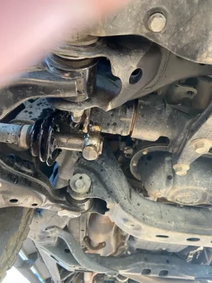

I have a 2017 Tacoma with a 2” lift that continues to tear the differential support mount and brake the cv axel please help
Just turning in 4x4 off-road not even in bad terrain
We need more information to help you out...thats super vague.
If you have photos or even a better more detailed description then maybe we can help diagnose for you.
I have a 3" lift, run my truck hard, and never broke a CV or have had issues with the diff mounts so im not sure what your doing or what your vehicle is doing to cause such damage.

I don’t have pictures of the support mount

Are you engaging 4wd at any speed?

Someone said it might be my differential drop spacers but it has them on it others say take them off

Good luck man. I think you may have had some bad luck with two odd balls in a row.
Hopefully it won't happen again.
That being said, I would try to remember very carefully exactly what you were doing each of the times it broke (a week before, and immediately before), and describe what you heard and felt in the truck.
we all need a bit more info to help you out. Something is obviously out of appropriate limits, and is allowing the joint to fall away and pop. Steering linkages? Suspension limits? Looks like stock shocks, is that true? Very, very odd.

Take the diff drop out...you shouldnt need it with a 2" lift, it could be the cause of your issue but I doubt it, I think theres something else at play with whatever is happening to cause such damage.
(I have a 3" lift and dont run a diff drop, and 0 issues)

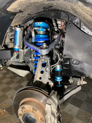

Im always running the truck hard, one of the few that really push a mid-travel setup like a LT setup. She sees liftoff quite often and has some pretty intense G-outs. Jumping she does great at, right now were working on the valving of the shocks to handle whoops sections and some higher-speed driving a bit better.

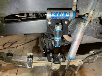

I attached some older photos of the suspension setup but it hasnt changed much. rear has limit straps now, working on getting some 3.0 12" shocks in the rear soon. Frame is all boxed, trussed axle, lots of gussets everywhere. Hopefully working with All Pro to upgrade the steering system soon so we can run 35's or potentially 37's next year plus some other goodies.
The extended travel Kings are just the normal OEM EXT king shocks.
