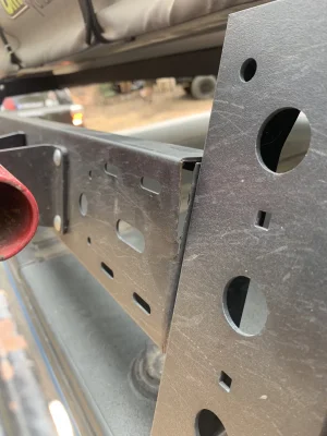

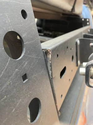

I did have an issue yesterday with one of the side rails. I’ve had the hi-lift mounted, and noticed the metal splitting from being knocked around. I contacted them on IG, and they immediately responded and said they will send me a replacement piece since they re-designed the rack recently. I felt that was pretty huge considering the rack is old and has been put through the ringer. They seemed like they were pretty supportive and wanted to rectify the situation. 8EDE7549-AE92-425B-A1A6-56EF884057B5.jpegB7C9D1C8-2D09-4578-9F19-1B026F9EFFF9.jpeg
