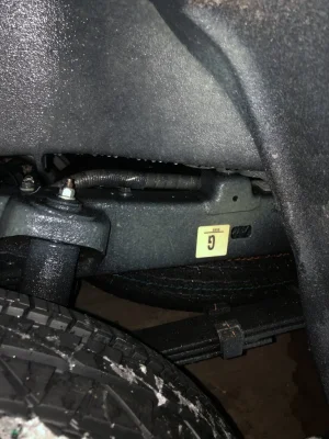

I went with the Woolwax and Fluid Film kit and sprayed it myself. Turned out great. It was about 200 bucks. I got enough leftover to do another car. I sprayed my truck when it only had 8 miles on it. Good luck.
