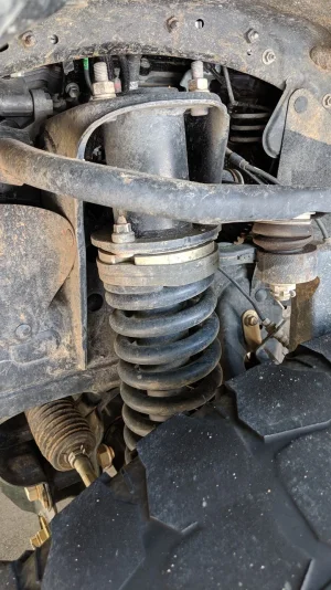

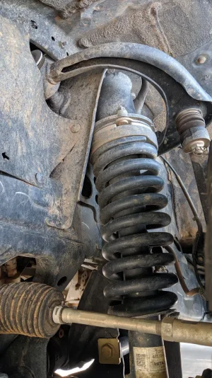

I'm also wondering when I replace my UCAs if I don't want to replace the springs too and get rid of the spacer. Different seeing rate might help with the bigger tires over the stock ones?
Wow, that's a big spacer...
That's your problem by the way. Something in there is bent.
You need to ditch this setup ASAP. I’ve never seen a spacer that big and your coil is bent. It seems dangerous and it is obviously bad for you truck as you already know.
A UCA kit with a set of coilovers is not too expensive for the safety and performance you’ll gain. Look for the SPC Light Racing UCAs, OME 887 or 888 springs, and Bilstein 5100 shocks if you want to save money. It won’t give you the 4” that you have now and you’ll be stuffing your 35s but it’ll be 100x better than what you have now.
If you can spend more, do it. That way you can have extra height and adjustability. But I think you really need to make a change here.
Do you have a link to the 4” Pro Comp “lift” you installed? I want to see what they advertised it as. What you have is not really a suspension lift IMO.
You've got a number of serious issues going on, combined they'll only lead to things getting worse.
If you want that big of a lift you're going to need to get a better setup because as it stands you're risking serious damage to a number of the stock components.
First off you need UCA's. SPC makes a highly adjustable set that will get you back into alignment. Next you are at a real risk of damaging your shocks as they are sitting at the long end of the stroke at rest. Any off-roading where you extend the shock any more and you risk hyperextension of the shock and they'll fail. Sounds nuts but yes it's happened, in short you need shocks. On top of that, the height you're sitting at places a sever angle on your CV joints/boots. Without aftermarket boots you'll likely tear your CV boots in a very short time. Without addressing those issues you are risking serious damage to your CV joints, ball joints, and God knows what else.
