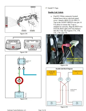

My rock lights are tied into the bed lights and work off of that switch.
