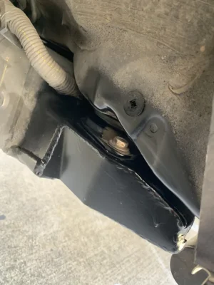

I can’t find all my other pictures of this area but I’m going to keep looking. Here’s some.

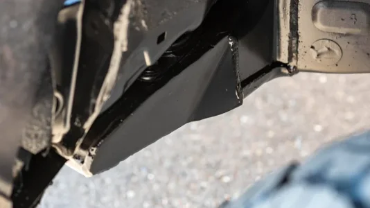

Some more from when it was only a chop (pictures in previous post are a relocation).
