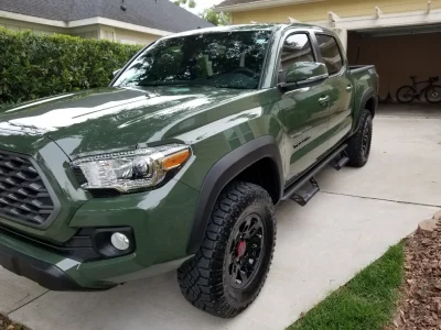

New Taco Owner Questions: I have a 21 off road XP (A Southeast Toyota Edition) and I'm shopping for the right lift kit for a 3.0" to 3.5" lift.
21greenXPoffroad
Oct 6, 2021
9
24
I contacted Rough Country (RC) and they indicated that the X Series has some special mods to the control arms etc., and that their kits will not work with the X series trucks. Does anyone understand the X series MODS they are referring to and what the limitations are? Is there a good turn key 3" lift kit available for the X series, or should I piece it together myself?
Goals:
- Overlanding
- Forest trails
- High desert
- I don't want to destroy my taco
- Family oriented fun
- Keep reliability

I've never heard of the "X" series before, could be just a marketing gimmick 🤷‍♂️

EDIT: looks like an appearance package to me.

Looks like a special trim for the Southeast region.
