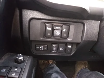

Trying to decide that for myself right now. Did you do the anytime switch, or the steering wheel control? I haven't decided which yet. I like the switch, but it is the 'small' style and won't fit in the one 'long' dash receptacle I have remaining (the one last blank on the left of the steering wheel). If I use the switch, I have to get a new plate or remove my AC power converter switch (which is useless) and replace it with that.
I got the better camera, but that's because it came with the kit by default. Looks just like what you linked
I moved some switches around, I'll take pictures in a bit!

That's what I did with my switches. To relocate the rear window switch I bought a harness extension. That's a 3D printed switch panel in place of the cubby. I can't stop thinking about whether mounting it underneath to give a view of where the wheels are would be awesome. The thing is, for parking I don't anticipate using the front much so It'd be nice if I could place it for better off pavement use.
