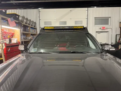

My Rig:
2023 TRD Off-Road Short Bed.
I bought it new, and had the dealer install the factory lift kit.
Mods done to date:
  • RSI Smart Cap: EVOa.
  • Rago: Bed Stiffeners.
  • Rago: Center Console Molle Panels & Device Mount.
  • Rago: Ditch Light Brackets.
  • 8 Switch Panel (Unknown, from Cali Raised)
  • Cali Raised: 27W Side Projecting LED Pods.
  • Baja Designs: S8 Light Bar (grill mount kit).
  • Baja Designs: Squadron-R SAE (factory location kit).
  • Baja Designs: S2 Rear Light Kit.
  • Expedition Essentials: Powered Accessory Mount.
  • Rear seat, overhead MOLLE panel: Don’t remember where I got it!
  • Meso Customs: Overhead and Map Lights.
  • RCI: Rock Sliders.
  • Billie Bars: Tailgate Cover.
  • Weather Tech: Bug/Window Deflector.
