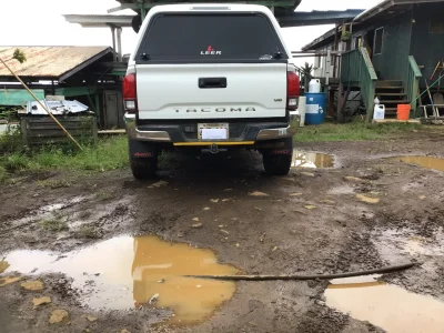

2019 Tacoma TRD LB , recently lifted. In for for service (Toyota Dealer), ask if they do a safety check (requirement in Hawaii). They told me I needed to put on mud flaps, once you lift your Tacoma. I purchase brand new, came with NO mud flaps.
Now my son is lifted the same height 2016, a independent safety’s station, said the same thing, till he re-check the laws, for his year, NO mud flaps was required, so he passed.
I decided to purchase them and maybe later remove them after the safety check? I had maps flap before on other vehicles , they get rip off while off roading, mainly when backing out a hole or ditch..

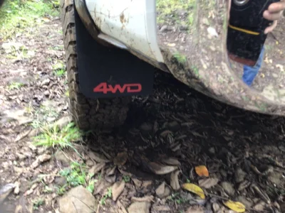

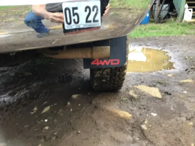

Amazon prime, I purchase Tufskins brand, Wow I like the stiffness, more of a hard plastic, does flex. Super easy install, perfect fit.
Remove screws , re-use the same screws ( Tufskins came with two longer screws) pop out the plastic plug, discarded, instead I use two stainless bolts 2.5 inches long. Ta-da. Less then ten minutes for each side.
I like the length and height . Sure my tires are a bit out..12 off sets.
Next step, safety check.

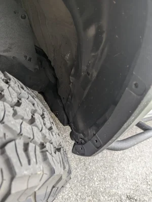

Factory screws some are too short. Due to the thickness of mud flaps , plus fenders are dented in . Making factory screws more flush in the fenders. Picture driver side front fender.
