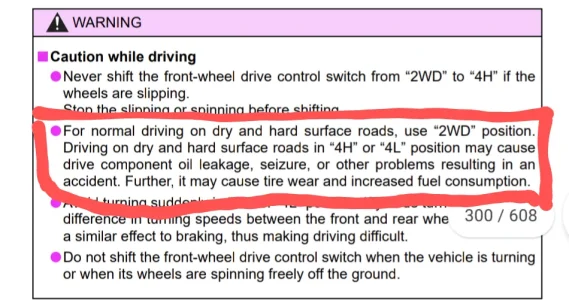

This is from the owners manual -
You guys are correct about hard pavements….(4h at Costco). I forgot to put in 2 wheel..
But on a hard dirt coffee farm roads…it binds mostly on turns…the Tacoma has a hard time moving forwards…then I put in reverse to free…happens a couple times every month..
It does feel like the brakes are locking…now I know it is the 4 wheel system…not function as one ?
