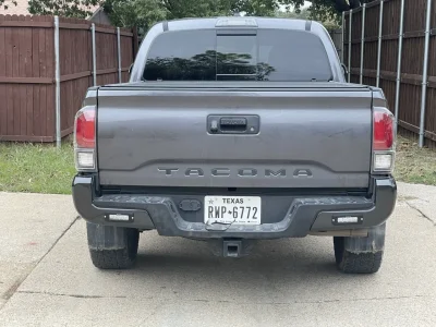

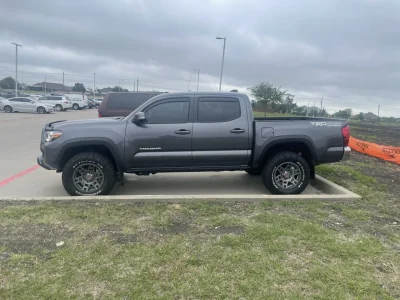

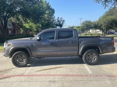

Thanks for having me! I just picked up this Magnetic Gray 2021 TRD Off-Road a few weeks ago at Family Toyota in Arlington, TX about two weeks ago. It was an August 2021 build with 4,000 miles that came from Florida. I went over it with a fine tooth comb when I went to see it and found virtually zero flaws with it.
It had a few mods from the PO:
  • Standard red tail lights from an SR/SR5
  • Lasfit LED headlight, switchback fog, tail/brake, and backup light bulbs
  • Hose clamp mod on the tailgate
  • eBay special smoked sequential mirror turn signals
  • debadged the tailgate V6 emblem
  • 265/70R17 Load E BFG KO2s
  • 17" x 7.0" TRD wheels in Graphite
Other than the random PO stuff, it's a really nice truck and I'm enjoying it so far. I came from a 2019 Nissan Frontier with the 4.0 & 6-speed manual combo. The Frontier was a fun truck to drive with plenty of power (more than the Tacoma), but the quality was not that great. For a 15 year old design I sure had too many problems. So I traded it for this one:

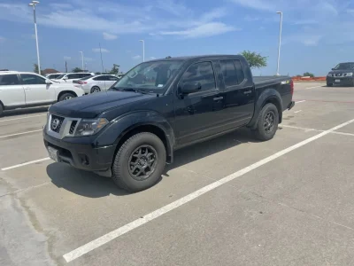

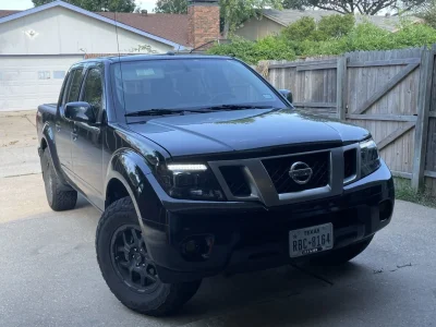

Here's the Frontier I was coming from:

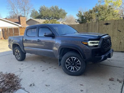

Here are some pics along the way from May '22 until now:
After downsizing to the new 265/65 Toyos

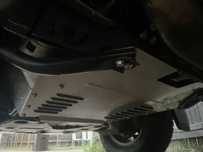

MillerCat Shield installed

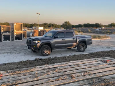

Just a pic of my truck on the dirty jobsite, thought it looked cool....

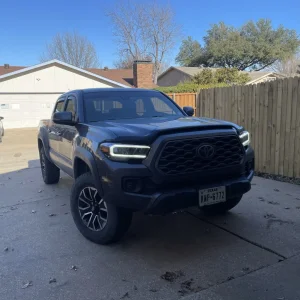

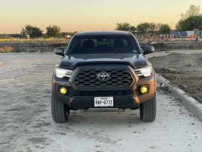

OEM LEDs + Rigid yellow 360 Fogs

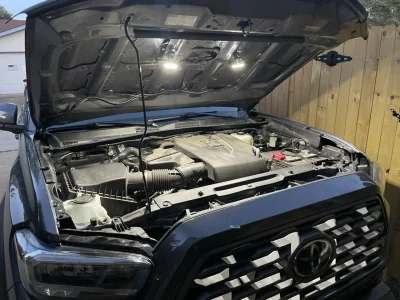

KC Cyclone under-hood light setup I built

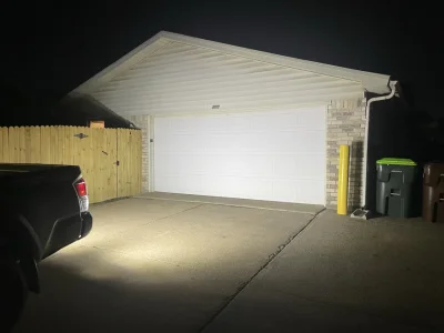

Pics of the backup light results after installing the Rigids - super bright and helpful!

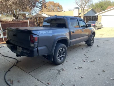

Random driveway pics showing the Sport rims and chrome-tip TRD catback

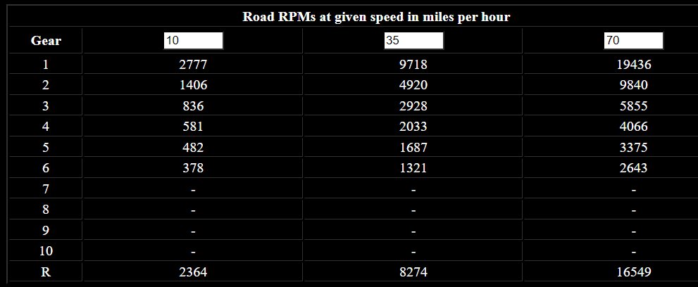

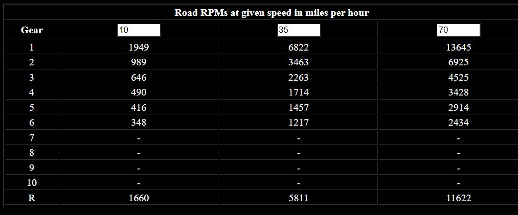

I don't update this thread much anymore, mostly due to time and laziness, but I did want to talk a bit about to upcoming project....regear day!
Back in June, I reached out to @Texoma on TacomaWorld (Triple C Chop Shop) about regearing my truck. I decided to pull the trigger and scheduled for his nearest day, Feb 4 2023. It has been a long 7ish months. Not only was the wait long and difficult, but it gave me a lot of time to decide and re-decide on the route I wanted to take. I initially chose 4.88 gears and said I would stick to stock tires. I'm really not a big tire guy as I don't want to do the work to fit them and I don't need them...i.e., there are very few benefits and pretty much all cons to me running a larger tire besides stock. I ordered the 4.88's and planned to use them.
A month or so later, I made the decision to go with 5.29 instead to get the most gear change for my buck. It's not an inexpensive project and I'd hate to regret the decision. The plan was to also step up the tires from 265/65R17 (30.6") to 265/70R17 (31.6"). 4.88 absolutely would be a solid choice on the 30.6s, but if I ever changed my mind on tires or anything later, I'd regret all the money I spent on them.
5.29s on 31.6" tires will be a bit revvy, about 2900 rpm at 70. This is actually right where 5th gear lands in stock form, so I basically threw away my stock 6th gear in exchange for much better low end performance. I think that will be ok. I'm a 70-80 mph driver, which means 2900-3300 rpm. MPG will likely take a small hit but not much worse than it already is. For the most part, my mpg is the same in 5th vs 6th gear anyways.
Another factor in this gear change is that eventually I want to run the Hilux Transmission (RC60F or RC61F) instead of the stock RC62F. The reason for that is gears 1-3 are shorter (higher rpm) and 5-6 are taller (lower rpm) making for even more low end performance while making the highway rpm lower which makes the highway cruise reasonable while having fantastic performance overall.
Stock RC62F Ratios:
1 - 3.982
2 - 2.017
3 - 1.321
4 - 1.000
5 - 0.848
6 - 0.713
R - 3.385
Hilux RC61F Ratios:
1 - 4.784
2 - 2.423
3 - 1.443
4 - 1.000
5 - 0.777
6 - 0.646
R - 4.066
I will also be running on the 265/65s I have for a little bit until I get new tires. That will be about 3000 at 70 and 3200 at 75. I'll probably cruise those speeds until I get the larger tires. It will be a wheelie popper but it will also be enjoyable.
4.30 and Stock Tires
5.29 and 31.6" Tires
5.29, 31.6", and RC61F Hilux Transmission
As you can see, the Hilux transmission would significantly boost low end performance in 2nd and 3rd gear. 1st would nearly be a granny, while 2nd would be good enough to start in. 3rd could be used at low speed, and 4th will be the same. Then into 5th and 6th for slightly better highway gears than stock (higher rpm but not over the top). Combined with 5.29 gears though?? Pure awesomeness. Not to mention reverse, which would be a HUGE improvement from both the 5.29s and going from a trans ratio of 3.39 to 4.07. It ends up being like a 50% gear reduction for reverse alone.
