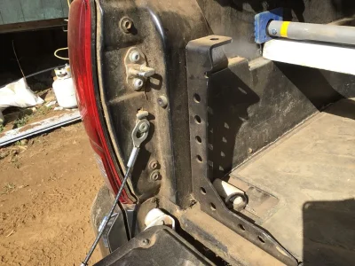

My bed stiffers ..Cali Raised…there is a tight fit for some of the nuts…Smaller hands really works better..

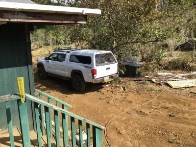

My roof racks ( ski) is for secure my fishing poles and a long 12foot fish gaff and 12 foot fishing net…

Know I know why? I have a Leer campers shell, often times one side rear lock gets jam on back window…
This morning I climb in side to adjust the locking device….
The problem was I had my ratching cargo holder across the rear bd….when I release the tension…my lock work normal…once release the bed move inwards…
Tacoma bed is so easy to push out..( my tension was where the 2x6 holders are located..the one near tailgate…
I could’nt believe how much and easy to push the bed outwards!
THIS IS NOT GOOD! Toyota composite beds, are very flexible, too easy push outwards…BAD engineering designs.. NOT enough reinforcements…..Is Toyota Tacomas is going down hill…?
Now I know why you should install bed stiffers…the bed is so easy to widened!

I install the Cali Raised bed stiffers, the problem with these designs…is bed bottom is flexing too?
Someone made need to design a complete U shape. Wider, and very ridged…the center bed is flexing too…? Study this?
NIce rig! Looks like mine - White TRD Off Road DCLB with with cap.
Thank you…. I like the space a 6 foot bed provides….most of our travels off roading isn’t too rough…just that 10% of it can be very rough..the dips ,humps, twisting on turns , angles, can be tricky…a 6 Ft lift would make it easier….?
