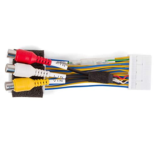

One thing you could so is just unplug the speed sensor pin on the head unit harness.
Just de-pin it from the connector. You can see here it's the green one.
This stops the head unit from thinking the truck is moving. It will still update on GPS by the GPS antenna, just not speed sensor.
This unlocks video while in motion and allows full function use of the head unit. No damage and keep the ability to revert back for any reason.
You could purchase the A/V adapter and it just goes in between the harness and headunit if you don't want to just unplug it.
They really just threw on a male and female connector on it so you could just unplug it.

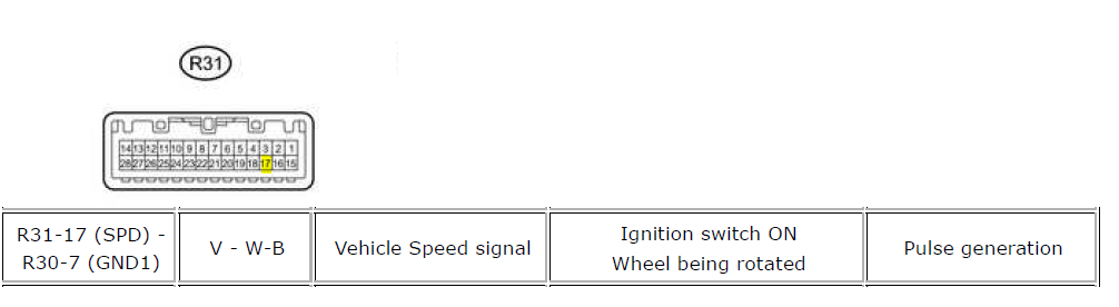

Dug this up in the Service Manual:
