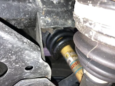

The lowest part of this front spring is covered with oil. No oil anywhere else. What’s leaking? Is it the shock?

Most likely. The stock OR shocks ride decent but they're not known for having a long lifespan (normally 50-80k). You might be able to get Toyota to warranty it, but if not, take-off's are available for cheap usually.
