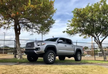

Here’s my OME 887 lift (2”?) on 265/70r17. Waiting on tires to bald before going 285. They do look a little bald from a distance.

the attached pic belongs to Reexcitybiitch on instagram. That's the look we want for my sons truck.

Headstrong is a good company.
285s are going to rub but there's some peoples say they won't with proper alignment and aftermarket UCAs but I'll agree to disagree on that point.

A solid suspension setup. if you want to spend the extra money Icon Vehicle Dynamics is a great suspension to run if you do a lot of offroading but also a lot of daily driving. With the camper shell and towing and constant bed use, you want a heavy duty leaf pack (I have heavy duty dakaars and add a leaf) and I'd also maybe recommend firestone air bags with an on board arb air compressor if you are towing a lot but I personally have no experience with towing and wouldn't know what weights are pretty intense and really need the bags. With that specific wheel a 285/75r17 will probably rub a little bit so the lower tire size would be the best bet. Also with stock upper control arms the bump steer is very present so I'd recommend adding those in with a lift because you can get a much better alignment while also making road driving much more comfortable
You mentioned the 4runner wheels. Something that seems to get overlooked a lot is wheel width and offset, and how the play a part in tire fitment.
Also remember the number one thing about tire fitment - lift doesnt change what size tire fits, especially since you plan on being out in the rough with it. It has to fit stock height for it to actually fit.
